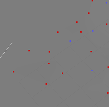

And I noticed it works with Edit Mesh on top, manages most of the vertices right, but misses some and also places some boxes on top of unselected vertices. In my old testings I also did see the same errors.
Here is a gif animation with the error
http://www.scriptspot.com/files/vertex_boxes_2.gif
