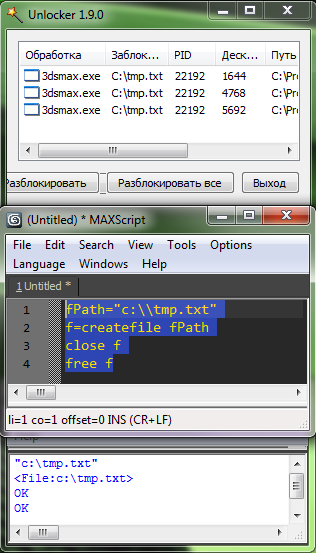

Why MaxScript does not release the files using the function Close()? Почему MaxScript не освобождает файлы с помощью функции Clo

hmm
here it works fine
after close and free, file is not locked to 3dsmax anymore.
did you try on other machines, systems or max versions ?
Yes I tried gc(), the same shit
around
oki, you can try the way around using Unlocker :)
Does it help ?
ah, if you use Windows 8, maybe try different location than root "c:\" and system folders.
Oh thank you so much! :) It Works!
And how i not thought of it! :)
great :)
:) great, did it work with unlocker or with different folder in win 8 ?
Unlocker
worked
great, but it still needs external unlocker... eh
I have checked
I have checked. Not only on this machine but on other.
3dMax 2012
re:ver
hmm, I checked here in win7 max2009 and max2014. it works in both for me :(
