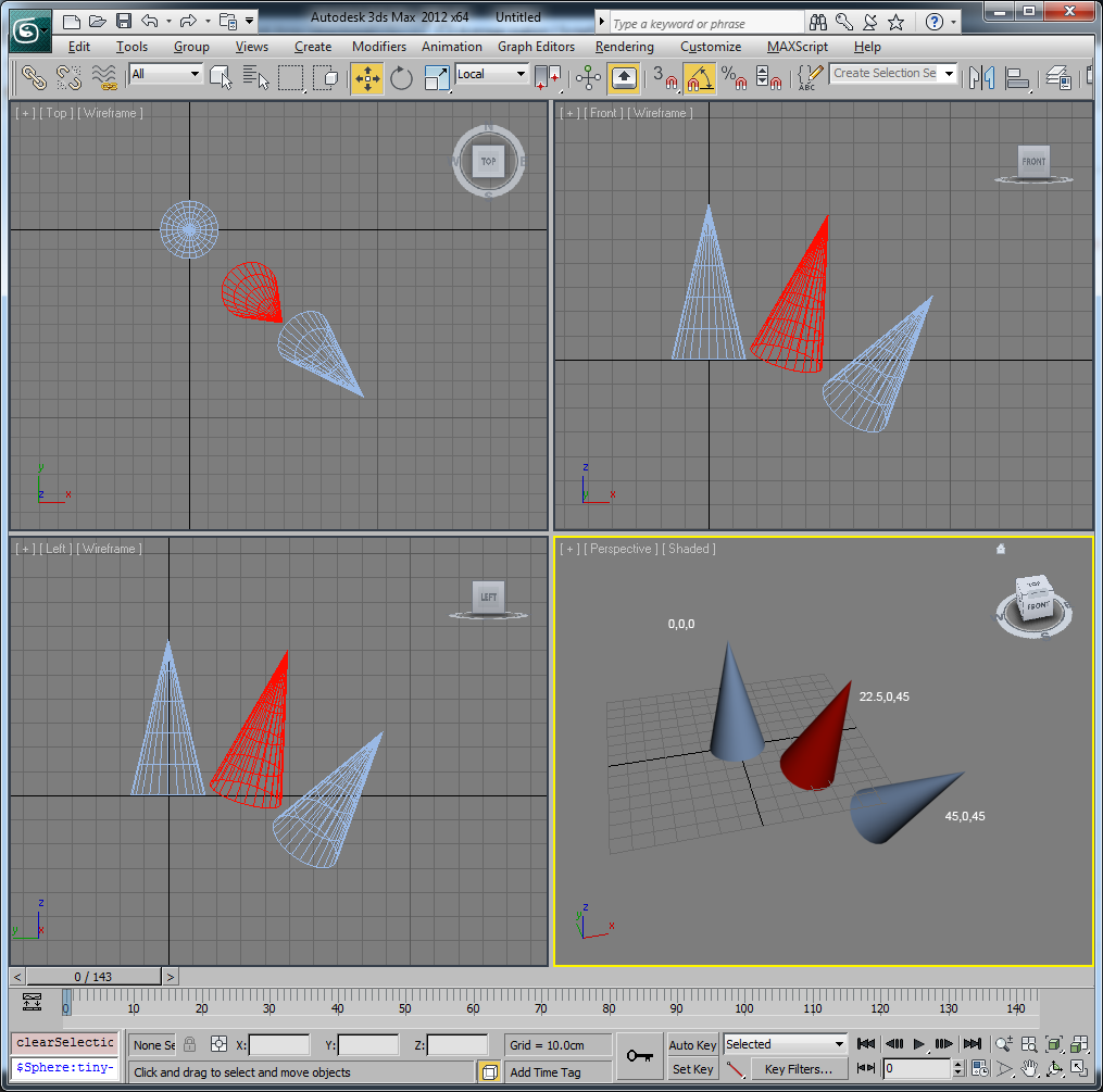

I want to find the average rotation for a selection of objects. Not just two objects. In the example image I show the average rotation for juts 2 objects, just to get the main point across.
I found this on cgtalk which blends matrices which is what im ultimately after.
I'm just not completely sure on how to get this to work entirely with multiple objects. Right now this only works with 2 objects. The biggest thing to get to work is the rotation. I know how to get average postitioning.

How about using this function iterating over all objects - e.g. find average between first two objects, then between that average and the third object and so on?
http://www.scriptspot.com/files/averagerotation.png
http://forums.cgsociety.org/showpost.php?p=6389088&postcount=2
I want to find the average of all selected object's matrices and then create and object and apply the average matrix to it.
