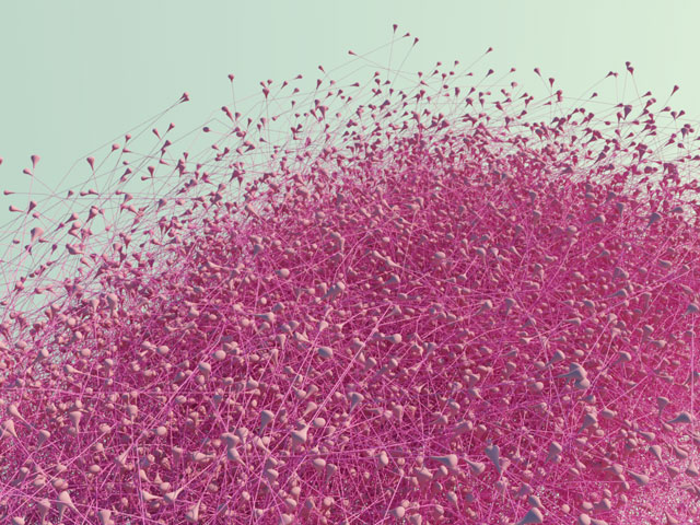

test
I want to create some lake bushes with this script. I am attaching test render.

test1
First code and file(max2010x64 +) example(see attachment):
Make instances of single flower, randomize wirecolor and place it on the last knot of the splines extracted from Hair Modifier.
Number of flower = number of splines
Open test1.max and run the code below
