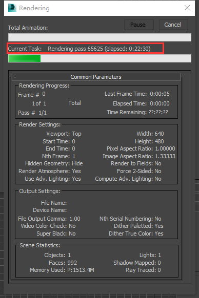

I now have a separate thread that needs to read the progress information of the rendering in real time, and how can I predict it?

I need to read the current rendering progress during rendering and save it as a txt document. Is there any way to read the rendering progress information?
jahman · 2018-07-24
I bet there's a better way of doing it. But here's the example how you can achieve it using BackgroundWorker and DialogMonitorOps

Encoding · 2018-07-25
Thank you very much for your help, this method has solved my problem. When I have other better methods, I will send it here to study together.
