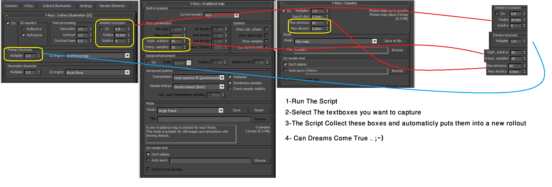

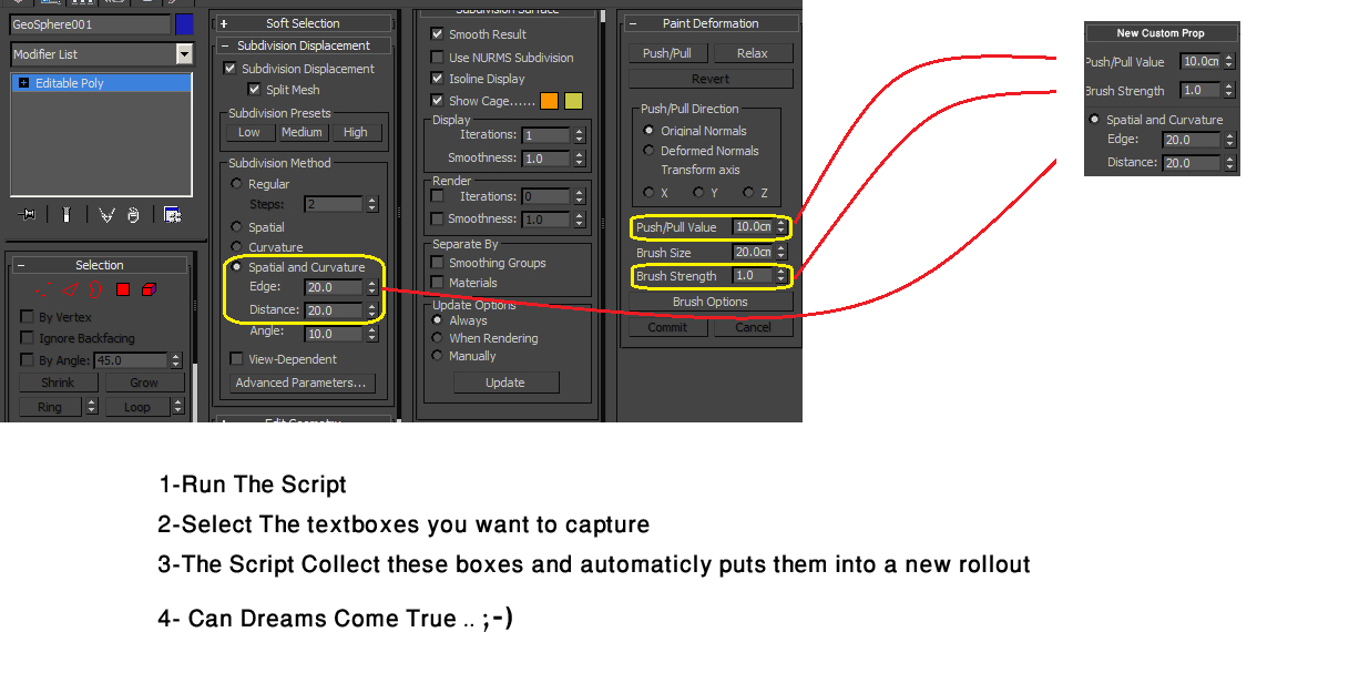

Hi guys and welcome to my dream ..
here is the deal :
A script which captures dialog boxes that you click on ,and put it in its own toolbar ( or rollout )
the pictures in the attachments will explain more .
the Benefits :
1- easy access to most used dialog boxes .. puts it in its own for easy and rapid access .
2- fast modification of the most used dialog boxes that you use when rendering, modeling, modifiers .. you name it .
2-dynamic rollout .. ( I mean : if you select just 3 dialog boxes it will make 3 boxes .. you select 6 and i will make 6 .. etc ) .
so .. Does dreams come true ?
