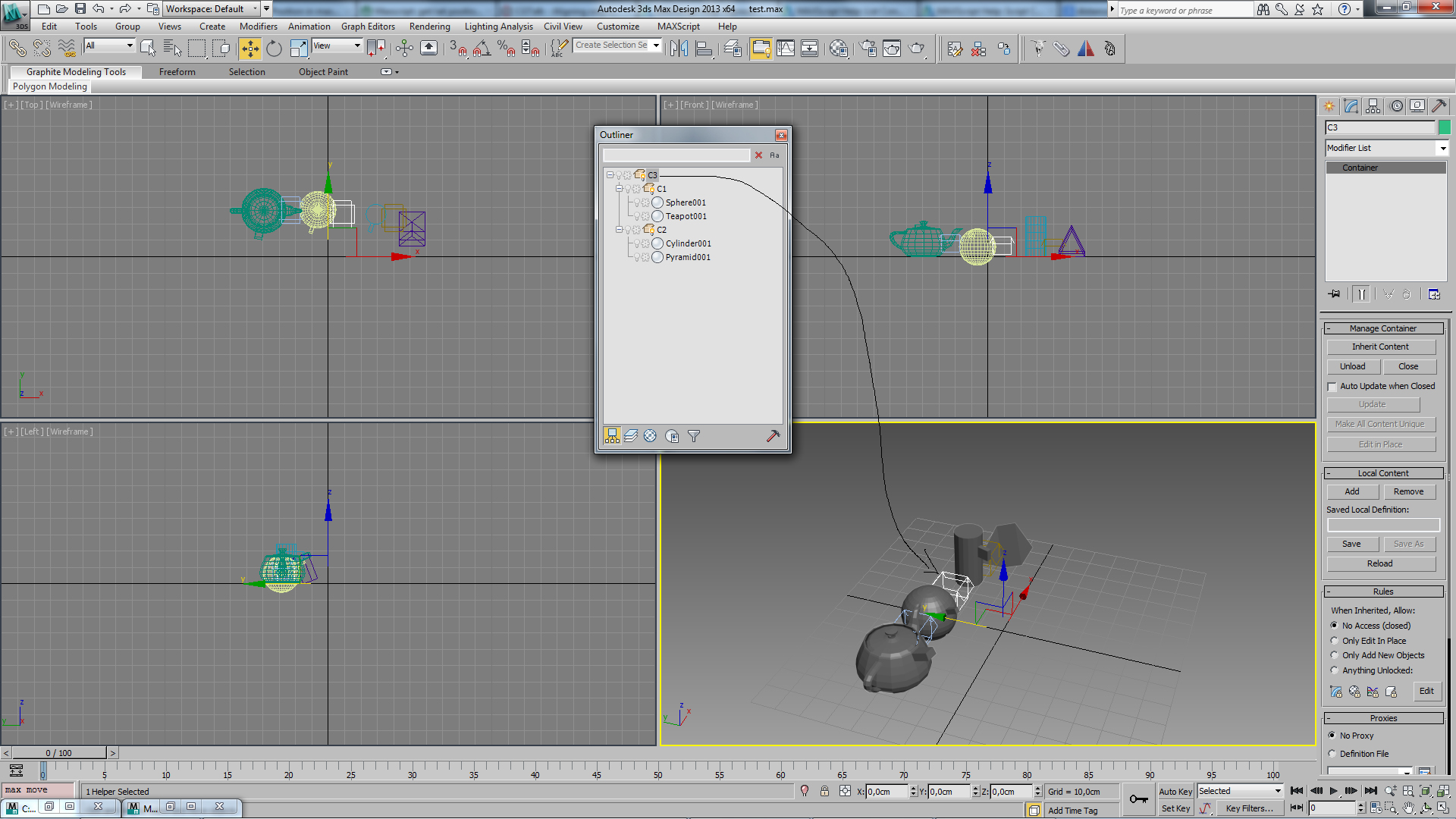

I have made a script that replaces the default 3ds max Mirror tool, and I need some help. I'm working with containers, so I want be able to mirror the parent container and all of its contents along a chosen axis. Now the problem is that I don't know how to make the whole selection mirror the exact distance from the objects to the parent container's pivot in the opposite direction (just like the default mirror tool does). You can see what I mean from the images below.
Any help would be greatly appreciated.

try this fn
-- ARGUMENT OPTIONS
-- axis enums: {#x|#y|#z}. Default X-Axis
-- center (miiror about point3) also you can use any object center. Default: world center
-- clone enums: {#copy|#instance|#reference}. Default instance
fn mirrorSelection axis:#x center:[0,0,0] clone:#instance = if selection.count != 0 do
local ax = case axis of (
(#x): [-1,1,1]
(#y): [1,-1,1]
(#z): [1,1,-1]
local parentslist = #()
maxOps.CloneNodes (selection as array) offset:[0,0,0] cloneType:clone newNodes:&clones
for i in clones do (append parentslist i.parent ; i.parent = undefined)
about center scale clones ax
for i = 1 to clones.count do clones[i].parent = parentslist[i]
free parentslist
mirrorSelection()
Thank you
