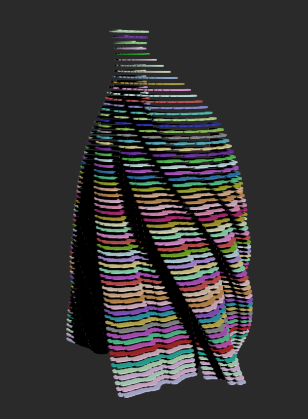

I have a bunch of "floor plans" I'm batch-importing into Max. They all come in flat on the ground plane as single meshes. They are named "Floor_1, Floor_2, Floor_3" etc...
My task is to spatially separate these floor meshes, relative to each other, in order of their names. So I need to put the same amount of distance between each floor to form a multi-storied building up the Z axis. (Ex: Floor 1 stays on the ground. Floor 2 is four meters above Floor 1. Floor 3 is four meters above Floor 2...) No need for instances/copies here, just need to translate the existing geometry to its new location. Attached is a conceptual example of a final result.
I've been doing this by hand, but it's getting quite tedious, especially for stacks of a couple hundred. I've searched for an existing script to do this, but haven't been successful.

| floorstack.jpg | 291.62 KB |
Many thanks, Miauu!
This works and saves me a ton of time! I really appreciate the speedy reply with this. :)
