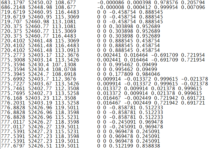

Hello, thank you for the script, it works based on example above.
Actually the TXT files have them as single line, but for some reason the website would not display them correctly, and i had to put move in one line, rotation in one line then add space, etc. for every single one of them.
They are as follows: name of the geometry followed by the move, rotate and scale, each column is separated by a TAB character, not space.
GeometryName->12011.95 23158.14 120.6522->-0.703436 0.071756 0.706524 0.028335->1 1 1
or: move, rotate, scale
while some have no scale and just move, rotate:
Would that be even more complex?
ps. i had to add "->" where TAB character should be, so the website can display them as should and not tangled.

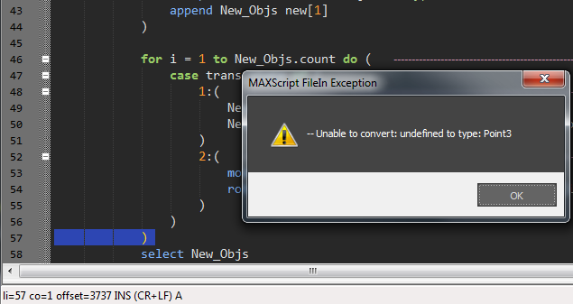

Error
The same error is shown on 3dsMax 2012, 2018 and 2022, except for 2012 at line 53, while other two at line 57 as in error.png screenshot attached.
I have noticed also, at line 21 it tries to find for "->" to be replaced with "_" there is no "->" in the text transform, i only meant in my comment above that i had to add those so the website will not tangle them, i attached another example.png screenshot as to how the values look in the text file.
I am sorry for the confusion.
