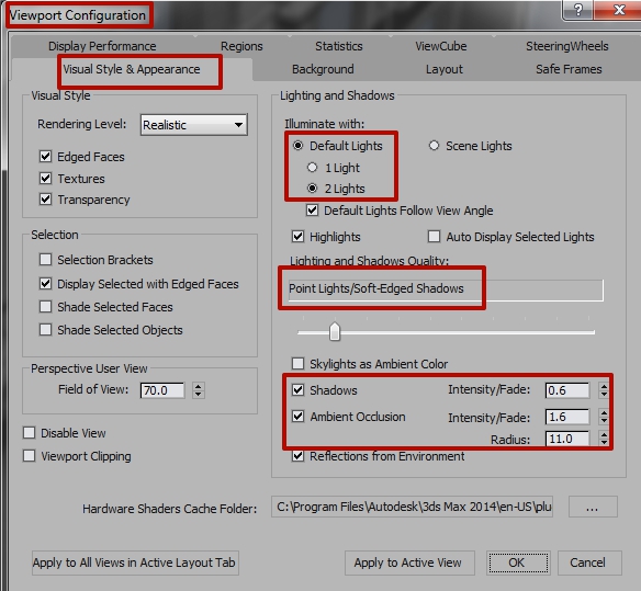

that you. essential script! could you please how to make Radius spinner always visible? i guess it may be floating panel
pos:floatpos style:#().
When the Radius spinner isnot visible?
Save this as ms file and put in in your maxroot/scripts/startup folder.
Or uncomment the first four lines, change the name, category, tooltip, buttontext parameters, save it as ms and drag-drop it in max viewports. Then you can assign a hotkey.
this is for Nitrous viewport
this is for Nitrous viewport settings with Default Lights so render doesnt matter i guess
these settings is here - Viewport Configuration - Visual Style and Appearance - Lightning and Shadows
Which render is this? And in
And in which tab/sub-rollout to find the settings?
