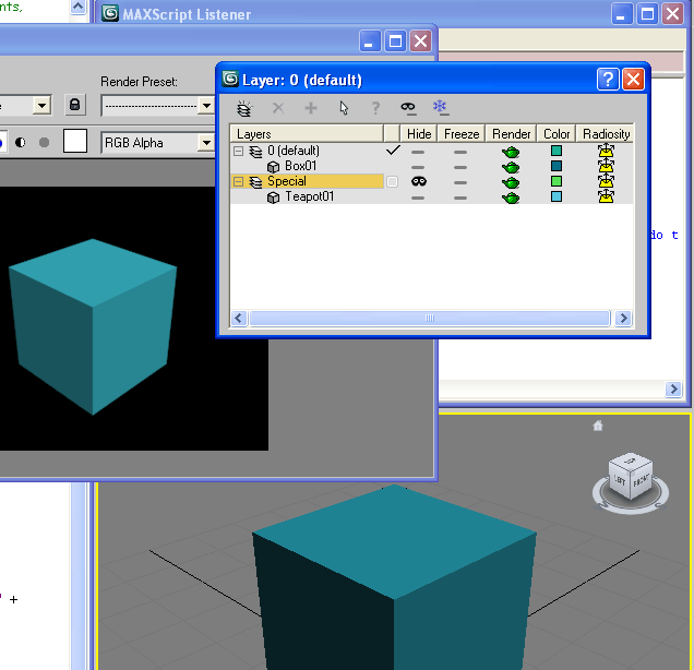

P.S. - Ok, here is a simple test to as a proof. You can do this staffs and without script:
Well, this is just to have some test scene, and here is the callback script:
Now press Render.
The result (see the pucture)

So, you made an example scene with box and teapot, create layer named "Special", moved the teapot to that layer, execute the callback part and nothing happens then render!?... thats impossible :(
The result i shows at the attached picture above - and it is - the layer "Special" is hidden and the teapot inside too, so only the box is rendered.
