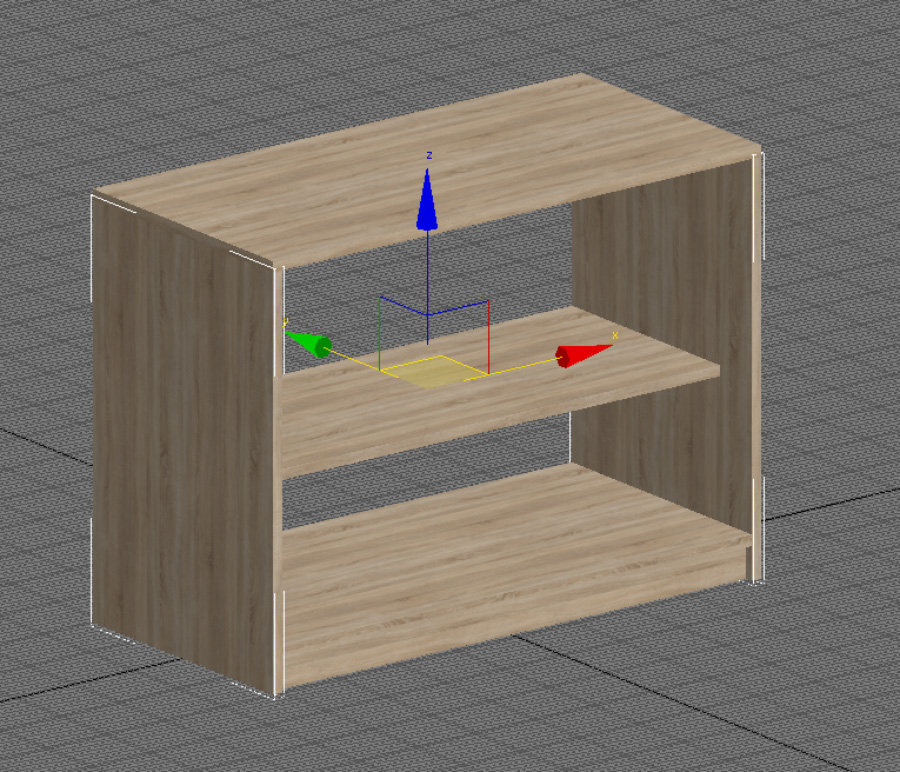

Hi! Please, help with a simple script. I have 10 grouped objects in a line with different dimension. I need to select obejects from goups with exect parameter. Function like SELECT SIMILAR, but BY DIMENSION. I'll try to explain the sequence of commands:
1. Select all objects in the viewport, but only those whose scale X > 200mm
2. Select all objects in the viewport, but only those whose scale Y < 300mm
3. Select all objects in the viewport, but only those whose scale Z = 400mm
OR
1. Select all objects in the viewport, but only those whose Dimension X > 200mm
2. Select all objects in the viewport, but only those whose Dimension Y < 300mm
3. Select all objects in the viewport, but only those whose Dimension Z = 400mm
Thank you all for your help in advance!
I have screenshots:.. I need
I need little script. First button to select only vertical object and second button to select only horizontal objects.

Try this:
YES!!!
MIAUU, It's perfect! Thank u BIG HUMAN very much! =)
