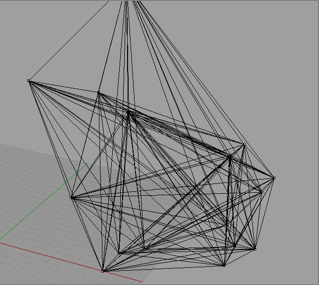

I have network composed by links and points,
now with Max script, i need to:
1) Create spheres (with different sizes) for each point of the network (around 10000 points)
2) Give a thin solidity to the links, as at moment they are just empty invisible lines. I guess i need to convert them to small cilinders.
is there any script to do this for all the elements?

Placing spheres in the position of points(with different size) is not a problem. 10 000 spheres can take a time, because you want each sphere to have different size, so they can't be instances.
The lines(I assume that you uses lines or editable splines) don't have to be converted to cylinders. You can turn On Enable in renderer and Enable in Viewport and can set the shape(radial or rectangular) and the size.
