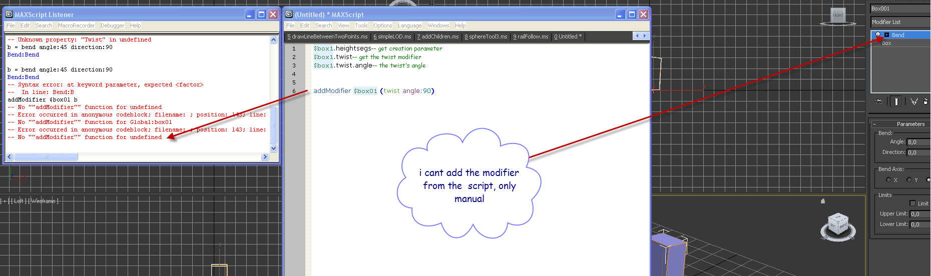

I try to follow this example script but dont work and i really apreciated some advice

You can't add the modifier
You can't add the modifier because the name of the selected box is Box001, but you try to add modifier to Box01
So, to avoid this use:
addModifier $ ....
or
addModifier selection[1] ....
-- the code below will add bend modifier to selected object
bendM = Bend angle:45 direction:50
addModifier selection[1] bendM
