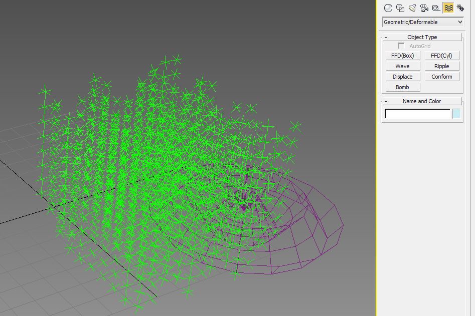

Does anyone know of an easy way to add noise to a selection of point helpers like the ones seen in the image. I would like to apply noise to them similar to what would happen if you were to add a noise modifier to a box mesh.
- create some points
- in create tab choose "space wraps"
- scroll to "Geometric/deformable"
- choose "ripple" for eg.
- draw it
- select your points
- "bind to space wraps" button (next to "unlink selection") and link your points to the space wrap.
- now you can move and play with the space wrap icon or with your points
Cheers

I don't know for noise but u
I don't know for noise but u can make wave for exemple.
see image.
