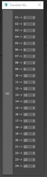

I made a little script to change/swap ids of a poly.
If somebody could improve it, so it could help more people (and me) :
It would be cool to have just existing ids in the rollout...
run not too slow so it could be use on 1M+ polys.
Cheers
how to use : select one edit poly, run the script, change values and click GO button.
| transfertuv.jpg | 24.99 KB |

Thanks MIAUU, it is far more
Thanks MIAUU, it is far more easy to visualise which Ids to work with now !!!
I see that you don't like my big button :-)
On the other hand, you killed my script, because you directly assign new ids before storing them in another ids, so you can't switch two ids without merging them, and other problems.
so i reintroduce my code in yours so it work again. the code is now a frankestein monster..
