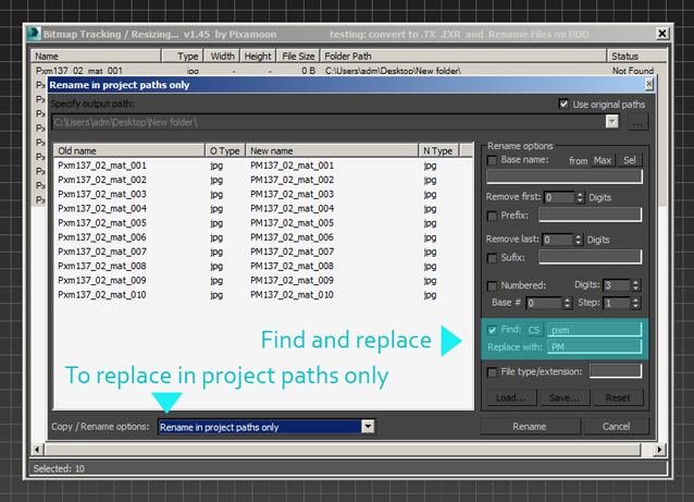

They have much more options to rename files in proj or on HDD etc.
Just a small screenshot how to replace in filename:
