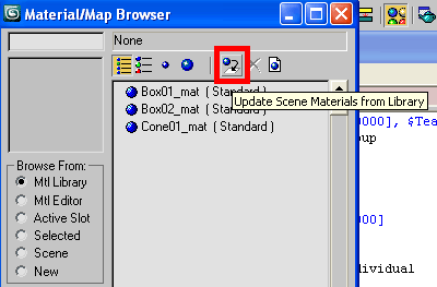

another idea
Ok, another idea - update scene materials (MtlBrowser feature).
It's works well here and maybe worth to try it.
--quick target scene setup:for obj in selection do obj.mat = standard name:(obj.name + "_mat")and when load your .mat file and update:
