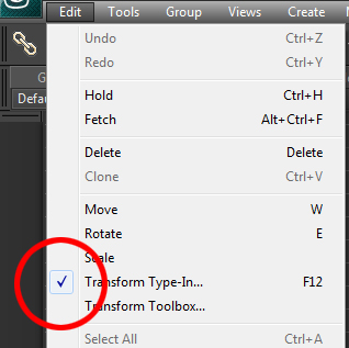

I'm currently having a little issue with my script.
I have create a subMenu in the main menu bar with some actionItem in.
I'd like to know how you can get the flag that came in front of the item, letting me know if the action item is executed or not (for example the dialog is open (flag on) or close (flag off))...
To know what I'm searching for, you can take a look at the attachment

For those who need this, here is a short example (the menuItem lunch or close a dialog in this case)
macroScript test category:"Test" --define the macroscript lunch by the menuItem
local isOpen = false
on execute do
if isOpen then --if open, close it
destroyDialog test
isOpen = false--and lower the flag
else --if closed, open it
fileIn "$userscripts/test.ms"--include the script
isOpen = true --and raise the flag
on isChecked return isOpen --return the flag
