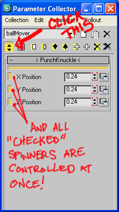

Hi guys,
I just discovered the Parameter Collector in Max and really like the functionality of it ESPECIALLY the multiple edit button that allows you to change all values of selected spinners at once.
Does anyone know how to duplicate this functionality so you could script it into an object's custom attributes so you'd have access to it in the modify panel instead of having to keep the Parameter Collector dialogue box open all the time?
I attached a screen shot of how it works.
Thanks for any help. I want to use this on my rig :)

This definitely gives me someplace to start. I dropped your code into my Custom Attributes and when I checked the box all spinners manipulated at once!
I'm going to try to modify it now so that each spinner (I have eleven for my eye control) will have a checkbox. Any spinner whose check box = true will be manipulated at the same time, AND be relative.
So if spinnerX is already set to 0.5 and it's now controlling spinnerY which is at 0.0, when spinnerX = 0.7 then spinnerY will equal 0.2. You know what I mean? It'll basically add or subtract from the spinner's original value until it min or max's it value range.
Anyway, I think it's off to a good start.
Thanks again. :)
