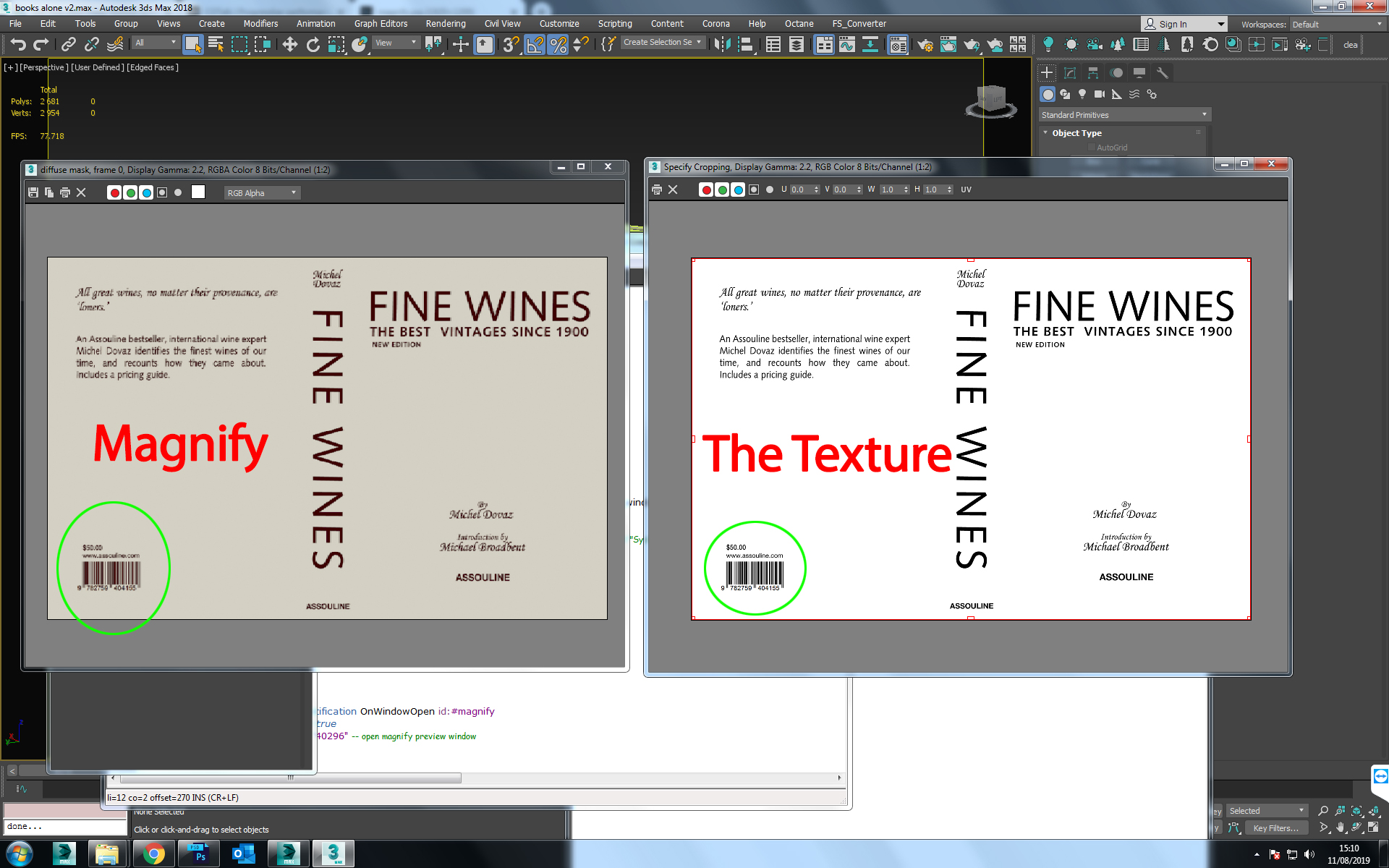

Take a look to the screenshot !
any other idea ? i have this issue only with Fstorm renderer...
yours looks very different compared to standard magnify window (doubleclick on a slot)

on the bitmaptex you have « view bitmap » (in the crop selection) - this is the right in my picture
double click on the material - this is my left one.
well, perhaps fstorm uses its own custom magnify preview.
or you can probably use renderMap to render and preview the map in desired resolution

Take a look to this video, you will understand, i've asked to the dev of Fstorm why he said to me that's a limitation of GPU renderer (to be honest it's not cause Octane and redshift works well). I think it set to a basic size like 256*256... that my question does it possible to force it to a best resolution.

Since you can't make it work even manually I doubt that there's a way to achieve it via maxscript or whatever else. The way texture looks on renderMap says it all.
Wonder if a square texture will perform any better.
nope :/ square or not, same
nope :/ square or not, same result. it's the rendering of magnify itself.
i Can put 10000x10000px always the same result.
