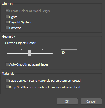

Ok, I'm realizing it isn't working exactly as I hoped. It reloads all of the links fine, but my materials get all jumbled up. After my fbx links are loading in, I have converted all of my materials to Standard materials. When I manually reload my links, I have to change the settings to what you see in the attached screenshot. Can those settings be controlled through a script like you sent?
Try this
Sorry for bringing this back up, but I am trying to get this working like I need it to again. It does reload all of the links, but when I try to use the translateMaterials:false, it still seems to reload the links with keep 3ds max scene parameters and assigments on reload checked. I need the links to reload with those check boxes off. Is that possible, and do I need to tweak that script for it to work?

Try this:
That works perfect. Thank you
That works perfect. Thank you so much!
