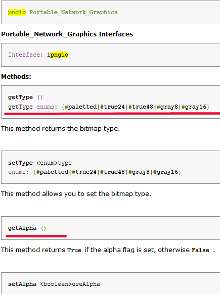

jahman · 2019-08-03
if you know that output file is png perhaps you can access output settings like this?

jahman · 2019-08-22
does it work?
	renderSceneDialog.close()
	rendOutputFilename = ""
	current_type = pngio.gettype() -- {#paletted|#true24|#true48|#gray8|#gray16}
	case current_type of
		#paletted : pngio.settype #true24
		#true24   : pngio.settype #true48
		#true48   : pngio.settype #gray8
		#gray8    : pngio.settype #gray16
		#gray16   : pngio.settype #paletted
		default:    pngio.settype #paletted
	rendOutputFilename = "c:\\abc.png"
	rendSaveFile = true
	renderSceneDialog.update()
	renderSceneDialog.open()
