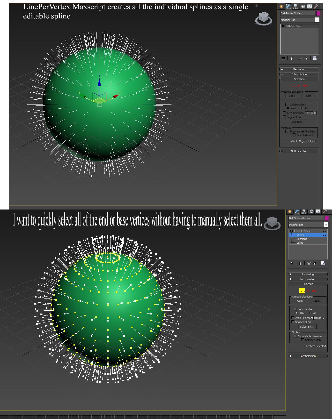

The problem is, he has a group of splines being used as guide splines for hair and fur. Each spline consists of just one segment (two vertices). All segments are attached as one editable spline, so in subobject mode, the bottom vertex of each spline is vertex 1, and the top is vertex 2. Is there a script which would allow him to easily select vertex 2 on each spline in subobject mode all at once? Obviously, he could use the paint selection tools, and different viewport perspectives to get the required selections, but seems like it would just be so much easier if there were a way to grab every vertex that was assigned to number 2, or 1, etc.
Here's a screenshot of what the splines look like... (see attached). It's basic Hair and Fur guide splines generated by maxscript.

That is exactly what I was needing. I appreciate LuxXeon for posting this request and really am grateful for your posting of this script. This does exactly what I was needing to do!
