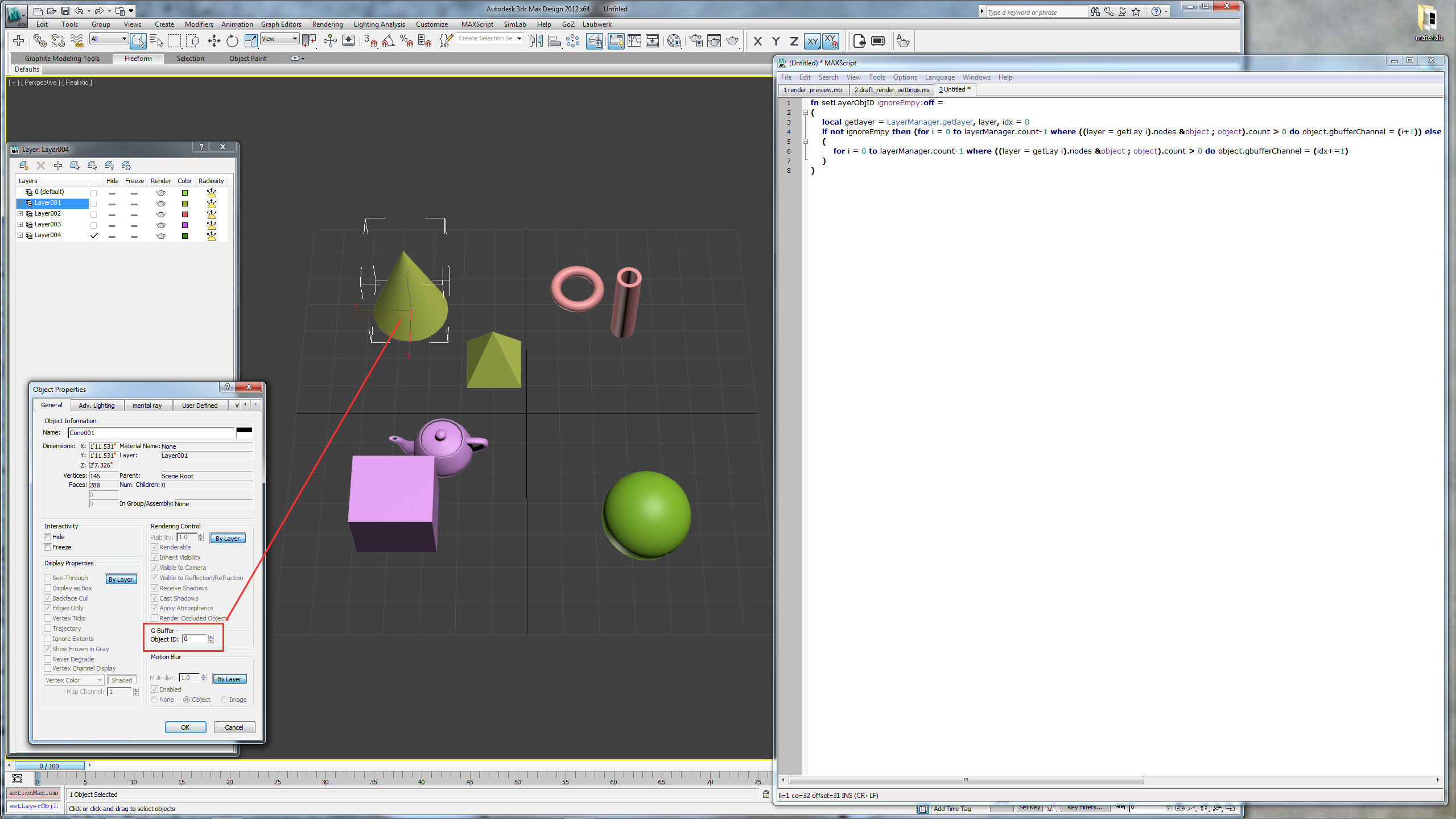

Same issue. All of the Object
Same issue. All of the Object ID's are still at 0.
You not run fn correctly. I suggest you to read some topics about functions in MaxScript Help. Anyway...
Firs run fn and then line that I posted as explanation.
I tried your attached script
I tried your attached script but the Object ID is still at 0
I corrected the fn. Try again
Now explanation about "ignoreEmpty" argument
If "ignoreEmpty" is set to "on" ei. you run this line...
...script will ignore all empty layers and use ID order 1,2,3,4,5,6 etc.
But if you run line where "ignoreEmpty" is set to "off" ei. ...
... script will ignore also all empty layers and skip layer number.
So if 3rd layer and 5th layer in the Layer Manager is empty then ID order looks like this: 1,2,4,6 etc.
Try this fn
