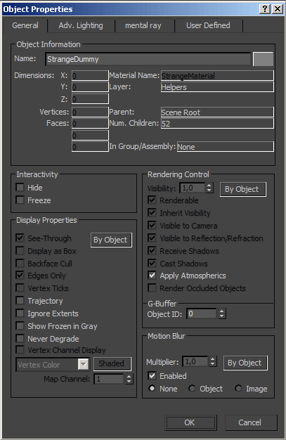

Hello,
I have a file with a Dummy that have a Material assigned to it. That's strange, weird, and I want to remove it but I cannot.
Do you have a tip ?
I've done :
print $.material
StrangeMaterial:Standard
$.material = undefined
undefined
print $.material
But nothing change as you can see!
