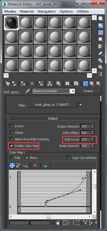

hi,i need help,i use Corona Converter scripts ,converter some vray material to corona material,but corona glossiness channel material which joined the output of fuzzy control, I want to close “enable color map” and modify “rgb level = 0.6”, I need a batch script, because I have too much material you need to modify the,sorry my bad english

to change RGB Level its easy, just use:
your_map = .... your_map.output.rgb_level = 0.6but to change "Enable color map" it's bit more tricky, take a look on this:
http://forums.cgsociety.org/archive/index.php?t-993502.html
basically what script needs to do is load each map to MatEditor slot than use UIAccessor to press/enable checkbox:
hope this helps
