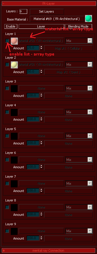

i would really appreciate your help on this topic: i don't need any UI, just if possible 1 click button that should be small fix after material conversion from VrayBlend to fR-Layer material.
I use finalRender R3.5 engine and after materials conversion from VrayBlend to fR-Layer material, this is usual situation and you can see it in attachment. There are 9 layers but only few of them are filled with materials - 2 in this case, and the rest of them are empty. Since VrayBlendMtl does not have these checkboxes, I need small and fast script to check all fR-Layer materials in entire scene (Max 2012 and 2015) and activate only checkboxes for slots that have materials inside (layer 1 and layer 2 in this case), while checkboxes with "none" label on their slots should remain unchecked (layers 3-9). It would be perfect if this could work for fR-Layer materials in MultiSubs, also.
Just for your reference because i believe most of you don't have finalRender R3.5 installed, both checkboxes and material type slots are array type as you can see on attachment.
Maxscript listener for this attachment and layer 1 checkbox (that is turned off) shows:
meditMaterials[1].enableList[1] = off
Maxscript listener for this attachment and layer 3 material list slot (that is emtpy) shows:
meditMaterials[1].materialList[3] = undefined

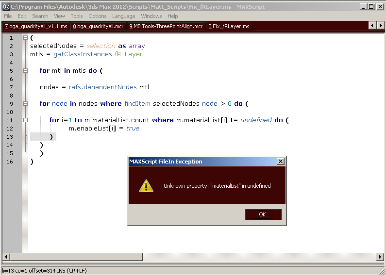

When i try with that code i get this message in attachemnt. Maybe it is not possible, and i can live with that, i will merge it in new scene as you told me. Thank you!
My bad. Change all m. to mtl.
My bad. Change all m. to mtl. and it will work
Perfect!
