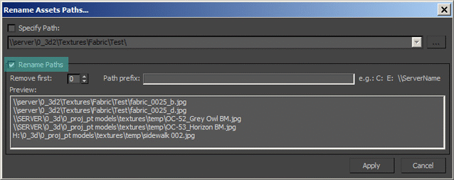

Change beginning of path or drive letter
There is also new way with Bitmap Tracking/Resizing to remove 1st path leaf (drive) and set new. Check the animation below.
It works with all kind of assets.

Batch change/rename paths
Hey,
Yes, please check Bitmap Resizing/Tracking - option "Set path..." and then "Rename"
http://www.scriptspot.com/3ds-max/scripts/bitmap-tracking-resizing
You can remove beginning of path by number of "\" up to the file name and than add new prefix/beginning
Right now works with bitmaps only but soon will be ready for all kind of assets.
