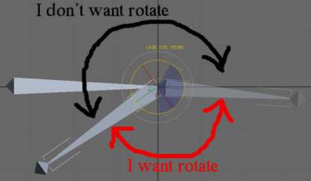

Hi, how to lock rotation by limit code without IK solvers if I moving or rotating the bone ?
Any suggest about it ? perhaps by script or controller script ... thanks
sample in this case like rotate bone hand/fore arm character
| limit-rotate.jpg | 44.7 KB |

oh yes, about my case... I have resolve the problem by myself, I just tried to assign float limit controller.
here the script :
$.rotation.controller.Z_Rotation.controller = float_limit upper_limit:0 lower_limit:-2.5 -- Z Rotation
