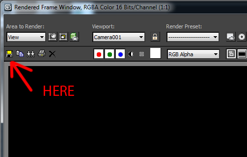

The problem with quick render is not with incremental output text file name. The scripts saves the oputput text, with the name of the image, given in the "render setup" dialog. When I press F9 and take a quick render I want to save a .txt file with the same name of the image saved from "rendered frame window"'s save image button.(I am sorry for the confusing description :). I have attached an image of the button). The method I cannot find is about that button.
