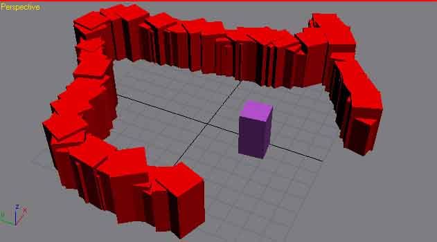

I am an architect and i have a concrete question ... how to write a script that would help me creating some hedge. I want the tool to be something like a spacing tool from 3d max but the objects created to be rotated on the z axis randomly.
Something like this in the picture(hedge created with 3 mesh modules) .
| img.jpg | 123.85 KB |

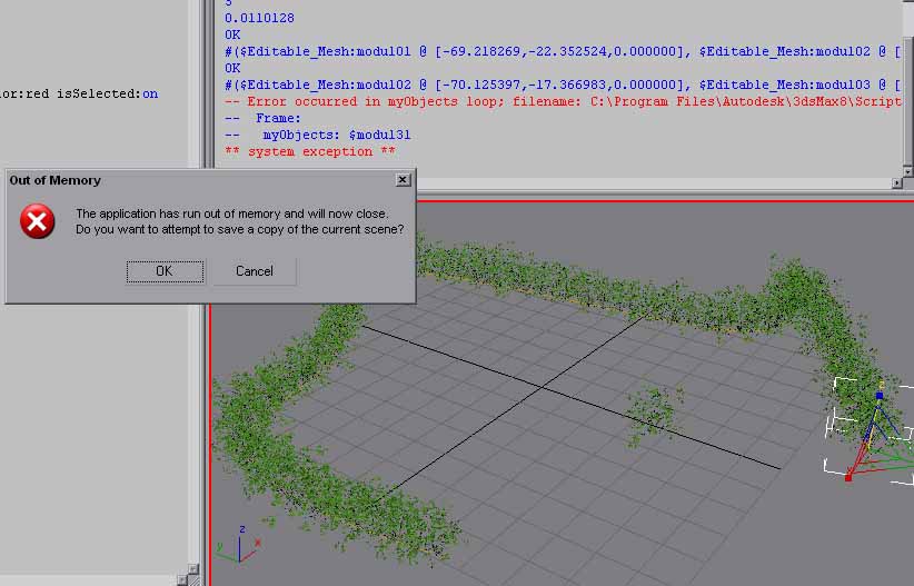

"my script shoud do basicaly a hedge from a module that i allready have, the script is based on for loops copying, scaleing and rotating the module along a spline. My problem is that with basic objects like a box or a cylinder it works fine (as i intended) but with my module it doesn't, at high setings ... because of an error ... that i don't know . i will post here the print screens ...
Can anyone explaine me how to solve this problem please !"
