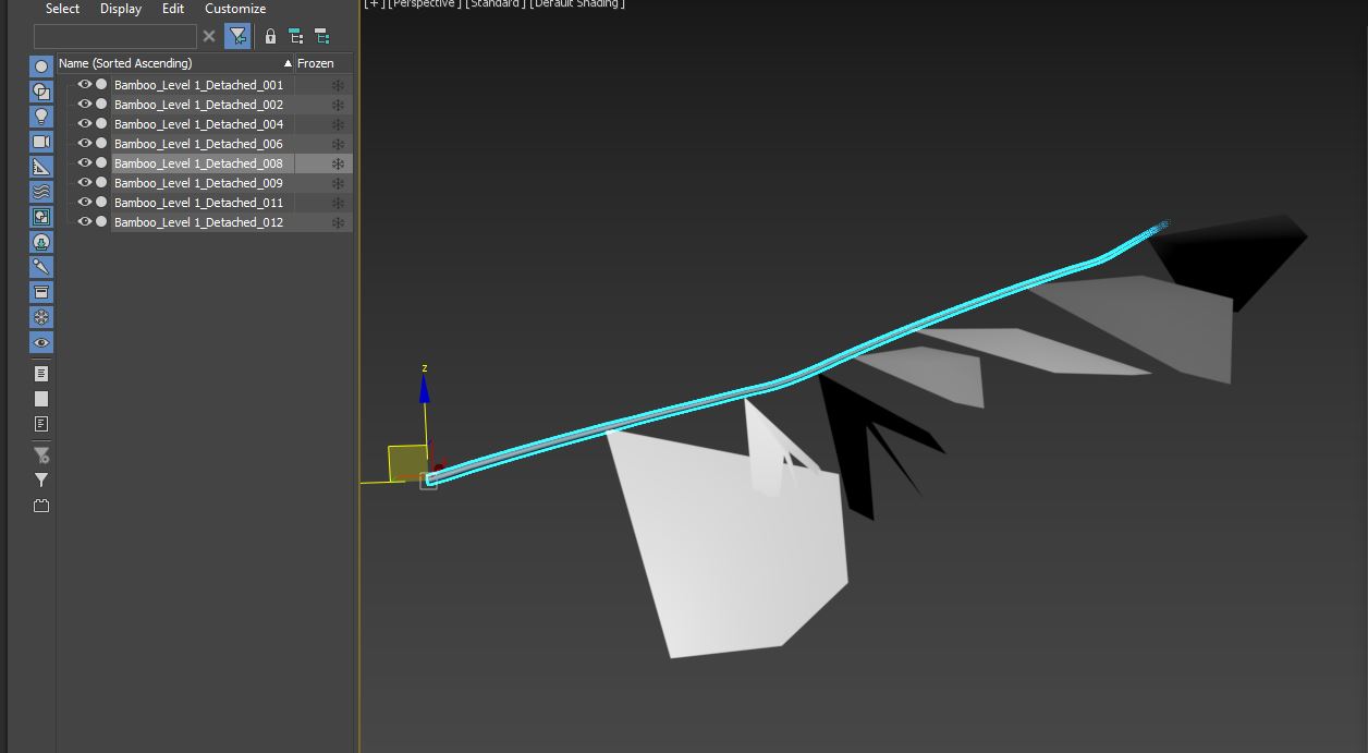

Hello everybody,
I'm looking for a script for the following problem:
You select an object and look for close by objects. The objects can be linked or just selected. So for each vertex of the selected object look if there is a objects pivot point close by (with a threshold) if yes, select this object.
Scenario: You have a branch of a tree with leaves. Everything is detached to individual objects. (see attachment)
Thanks in advance!
