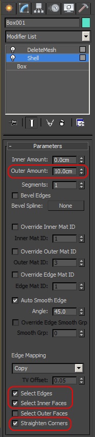

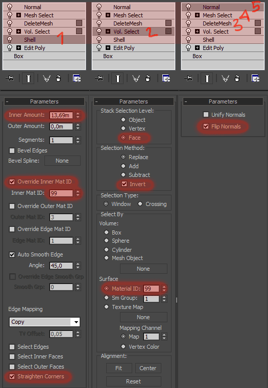

is it possible to combine 5 modifiers into new one? here i attach illustration how simple sequence of actions produce straighten cornered push
Reply to harumscarum
LittleLordPotala
About Combo-modifiers
Maxscript doesn't allow to combine multiple modifiers.
But, anyway, you don't need 5 modifiers to do what you want but only two :
Shell + DeleteMesh. Look at the attached screenshot.
I also updated the small script "push2" that will automatically add the deleteMesh
modifier when you change, the first time, the spinner value.

For the push modifier, it's impossible to add "straighten corners" option,
but I wrote a small scripted plug-in that modify the Shell modifier.
I called it "Push 2". So after you apply it, you just need to convert your object into editable_mesh or editable_poly, then delete the selected inner faces.
Of course, you can directly use the Shell modifier but with the script, it's easier. (See the attached file.)
