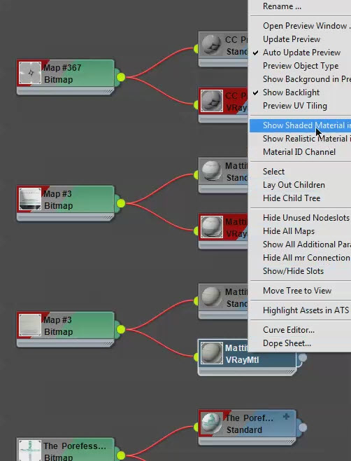

can you guys help me with one script that can make the option of "Show Shaded Material in View-Port" for a selection VrayMat's?
Now I have to do it one by one manually after the standard materials had been converted.

My situation is more related with the slated material window and Vray (3.10).
Every time that I apply the vray convert material,even if the original material had the option on,the new vray doesn't and can't do it with multiple selections, only individually.

For all scene VrayMtl try
For all scene VrayMtl try this work (for selected object try to find this kind of loop in another scriept that use list selection):
for o in getclassinstances VRayMtl do o.showInViewport = true
