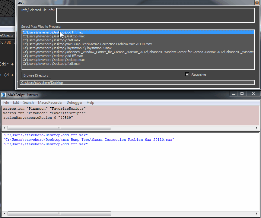

I'm trying to figure out why the arrays is not following like it's suppose to or at least I think it should. See code below:
try(destroyDialog test)catch() rollout test "test" ( editText fileinfo_lb "Info/Selected File Info:" height:50 align:#right readOnly:true multiListBox maxFiles_mlb "Select Max Files to Process:" button browseProcess_bt "Browse Directory" align:#left across:2 checkBox recurse_cb ":Recursive" checked:true align:#center editText processDir_et ":" fieldWidth:780 align:#right Fn getMaxFiles_fn dir = ( if recurse_cb.checked then ( local dir1 = getDirectories (dir + "*") for d in dir1 do ( join dir1 (getDirectories (d + "*")) ) local files = #() for f in dir1 do ( join files (getFiles (f + "/*.max")) ) join files (getFiles (dir + "\*.max")) return files )else ( files = (getFiles (dir + "\*.max")) return files ) ) on browseProcess_bt pressed do ( if processDir_et.text == "" then ( path = getSavePath caption:"Choose Directory for Scripts" initialDir:maxFilePath if path != undefined then ( processDir_et.text = path getMaxFiles_fn path maxFiles_mlb.items = (getMaxFiles_fn processDir_et.text) ) ) else if processDir_et.text != undefined then ( path = getSavePath caption:"Choose Directory for Scripts" initialDir:processDir_et.text if path != undefined then ( processDir_et.text = path getMaxFiles_fn path maxFiles_mlb.items = (getMaxFiles_fn processDir_et.text) ) ) ) on maxFiles_mlb selected i do ( --fileinfo_lb.text = fileNameFromPath (maxFiles_mlb.items[i]) print maxFiles_mlb.items[i] -- = fileinfo_lb.text as string --print (maxFiles_mlb.items[i]) ) ) createDialog test 800 270 style:#(#style_titlebar, #style_sysmenu, #style_toolwindow)
Should:
Not follow the array and print the name of the currently selected file to the listener?
Thanks in advance
Thank you
I knew I needed to do something with a for loop in there. With this fix it works but it also prints out in the listener sometimes the previous selection then the correct selection. See GIF (BTW I got this handy little screen to GIF app if anyones interested.) Made my day this lol.
