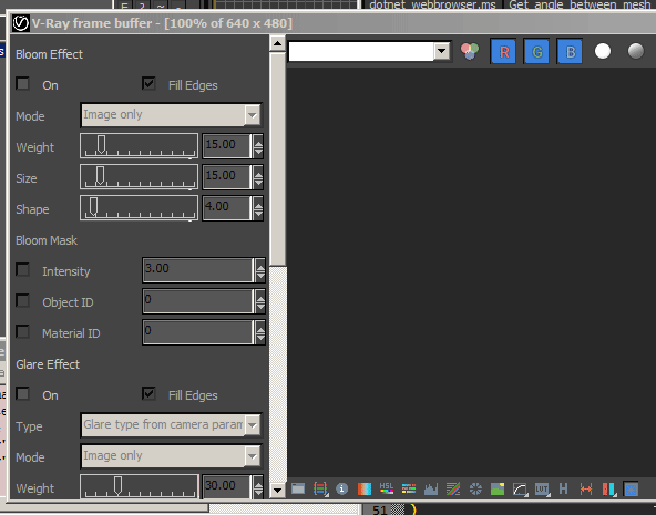

Hi, i couldn't find a way to set the VFB Open Lens Effect settings dialog to False.
It doesn't show show up when i call the VfbControl() in the listener too. Is there a way to do this? i like to permanently set it to False.
Thank you :)

Right, i had these but it's more about the panel itself.
For example; you can hide the history panel with: vfbControl #showHistory false
I like to hide the panel with vfbControle #ShowLensEffects false (or something of this nature, i can't seem to find a it)
thanks :)
jahman · 2019-02-03
Doable. But this task involves a lot of winapi work.
remykonings · 2019-02-03
Oke i see.
I'm early in learning Maxscript, so that is probably not doable for me at this point.
Thanks for the reply :)
