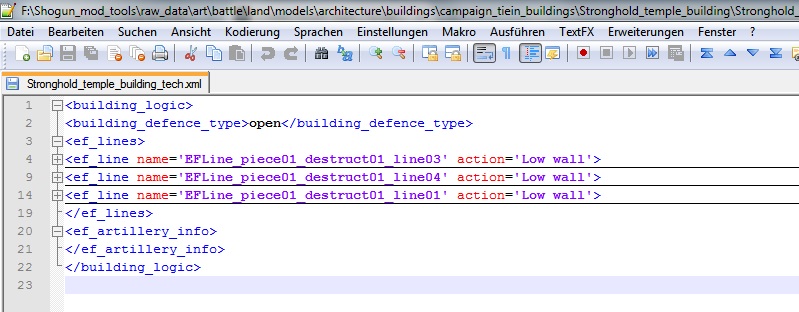

Hey guys I got a question about Dotnet and writing out xml files.
Currently I'm writing a script which should export data to a .xml file, which has to follow a certain format to be usable in a game.
I want to recreate the format of "open" in the line (see attachment please) but I have no clue which command I have to use.
I know how to add attributes to an element, but the thing I want to add, should not be an attribute sadly :/
Can someone give me the right direction?
