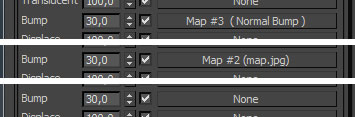

Hello everyone,
I am trying to convert a vray material into a standard material, and I have a problem to write this algorithm in MAXScript :
if (the bump map slot is not empty) do
(if (the slot contains a normal map) do (normal map goes to bump slot of the standard material)
else (bump map goes to bump slot of the standard material))
Probably I'm wrong, but the problem is that i don't know how to differentiate the 3 possible choices.
This is my actual code which is wrong :
for o in geometry do ( if classof o.material == VRayMtl do ( newmtl = Standardmaterial () if (o.material.texmap_bump != undefined) do ( if o.material.texmap_bump.normal_map.filename != undefined then ( newmtl.bumpMap.FileName = o.material.texmap_bump.normal_map.filename newmtl.bumpMapAmount = o.material.texmap_bump_multiplier ) else ( newmtl.bumpMap.FileName = o.material.texmap_bump.filename newmtl.bumpMapAmount = o.material.texmap_bump_multiplier ) ) o.material = newmtl ) )
Thank you.

I found the real problem.Do
Do you know how to test if inside the Normal Map there is a map ?
Your script doesn't contain this case.
In your script, even if you remove or not the line "obj.material.texmap_bump.normal_map.filename != undefined", the VrayNormalMap won't be converted to Normal Map with a material with a Normal Map with no map inside.
In my script if I add the line "o.material.texmap_bump.normal_map.filename != undefined" as a condition, and if I have just a bump map in my material, I will have this error "Unknown property: "filename" in undefined".
I will be grateful if you can solve this problem.
Rodman
if you want to test if
if you want to test if "NormalBump" have "mormal_map" use this
For your code not need to twice check NormalMap, try this
Thank you ! I've used both of
Thank you ! I've used both of your codes to integrate it with mine. I understand how it works now.
Rodman
fine.now you can continue
fine.now you can continue with the rest of script.
cheers!
