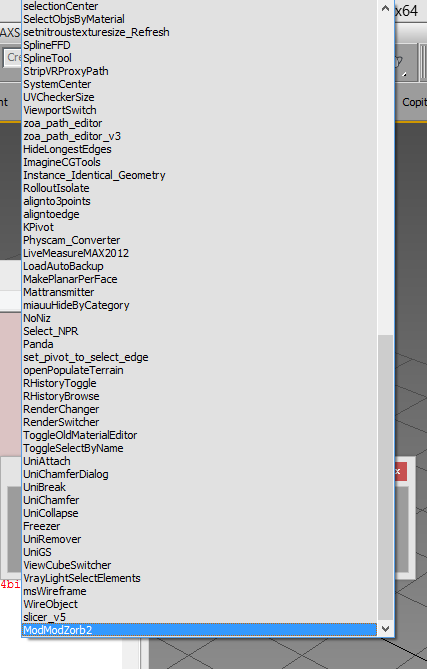

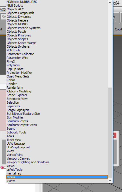

Hello again,
I noticed that some category items slipped out of the order and the Macroscript is not alphabetical at all. I dont know if I did anything wrong, so I attach the latest code, plus some screen dumps.
There is a part on row 60 I commented out (maybe I shouldn't?) - what does it do?

- How can the dropdownlist categoryList and mcrNamesList be ordered alphabetically?- - Does maxscript support refresh, so that there could be a button next to "Run", or do I have to close and repoen?
