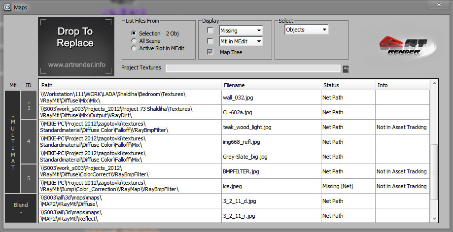

This is what I came up with
Now I can easily go on! Thank you, Barigazy! You HELPED me lot!!!

I thought to draw all buttons like you showed me in this function:
Here it is possible to put location and dimensions! In fact I need only one container where I could add buttons!
Is it possible to define just one container where I could add these buttons, or should I make a thin column on the left and one wider on the right where I could add all the buttons?
